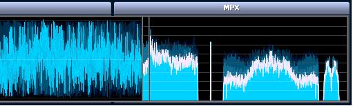

GUI bug when enable and disable BS412 ( you can disable the warning by checkbox). And see result that i`m posting.
