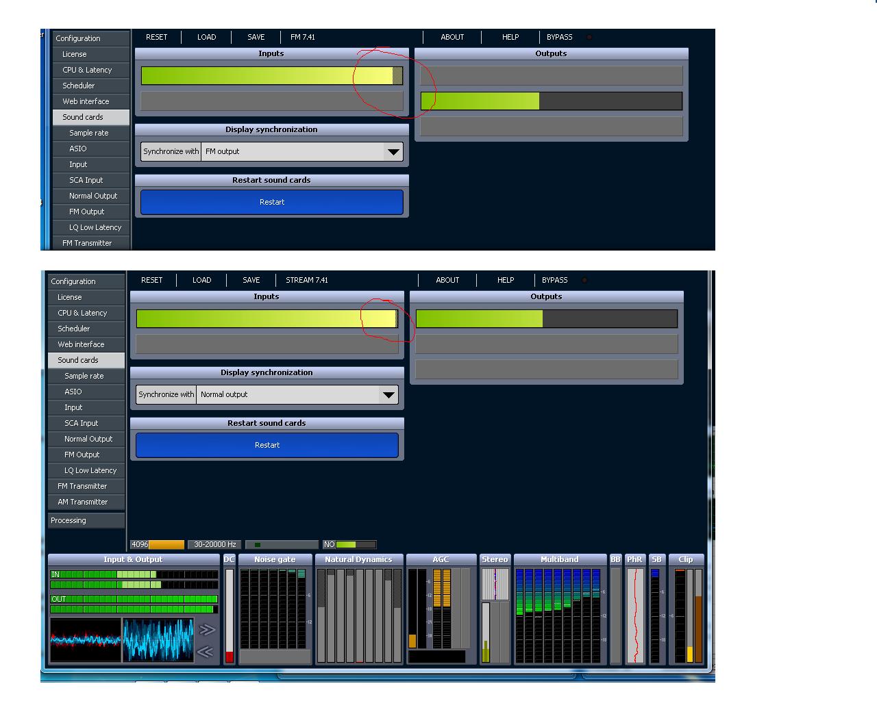

good stuff !!! :lol:
a question: is this normal, in the previous version did not.

NRG: Hm, that's indeed a bug - should have no impact but it shouldn't be displayed.
