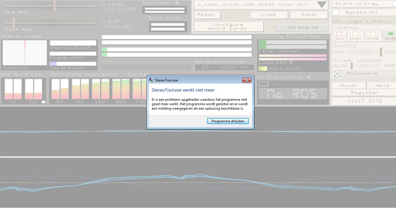

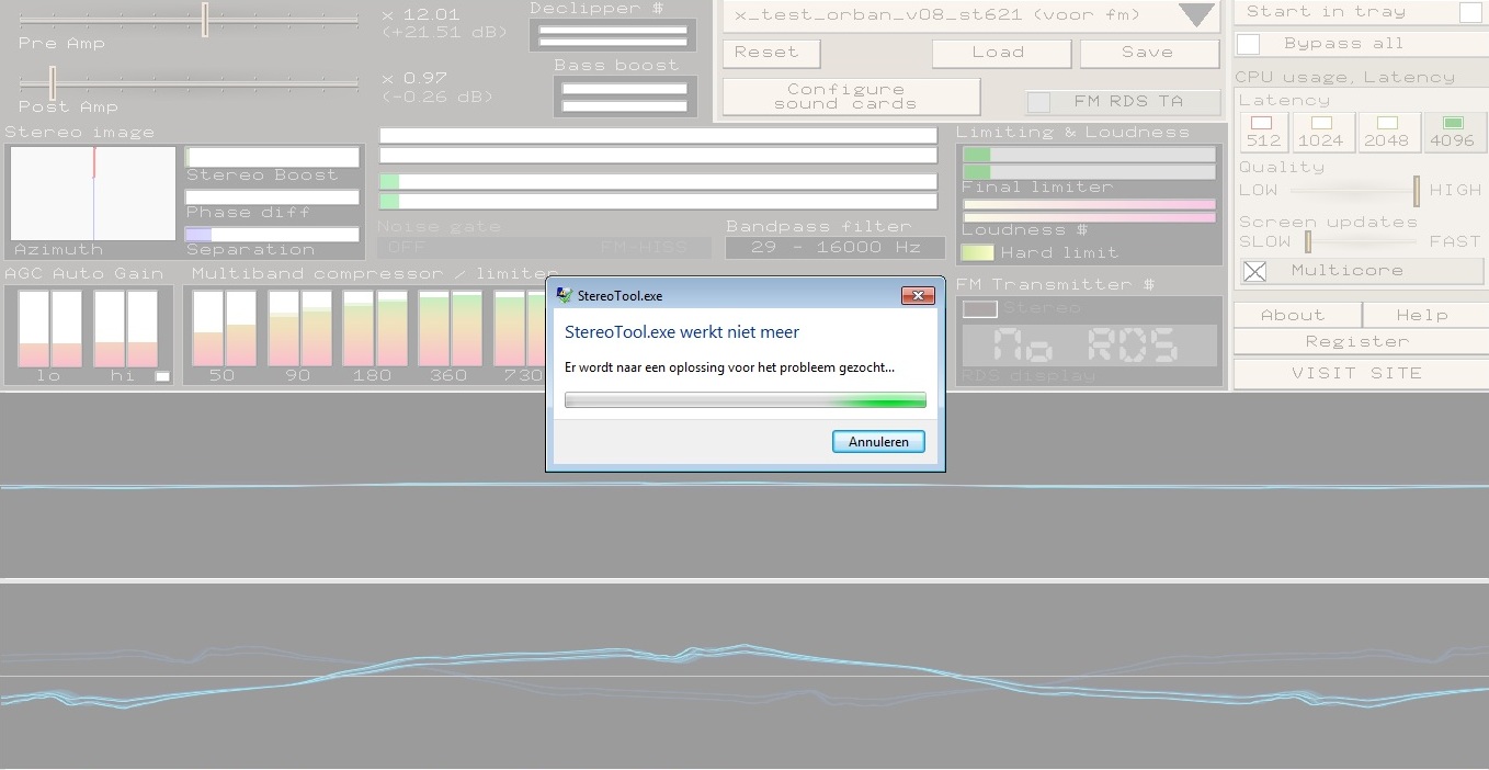

I made 2 printscreens, It doesn't say what the error is...
Maybe the problem is with the emu card, shouldn't be, because till the samplerate of 128khz everything works fine...
The emu card take some time to lock the samplerate (automatic) but before the emu has locked the samplerate (in this case only with 176.4 or 192khz), stereotool is already shutting down. The only way I can set the samplerate to 192 Khz is as I described above.....
