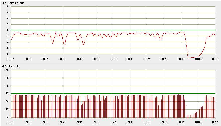

PostPosted: Fri Jan 27, 2012 2:19 am
Hey everyone,
I got the measurement results back and it looks promising. There were indeed huge gaps in the audio (much worse than I had expected), but the peak level seems to be ok.
This new version has less gaps (not completely fixed yet, but the worst case gap that I measured was -12 dB before, now it's -2 or -3). In music I haven't seen anything below -0.8 dB yet.

PostPosted: Sat Jan 28, 2012 5:42 am
Worst case gap is now down to -0.8 dB. This version is probably good enough to put on the air, although it needs to be tested more.

PostPosted: Sun Jan 29, 2012 3:34 am
Sliders and display added!
Stand alone: http://www.stereotool.com/download/radi ... EST004.exe
Winamp plugin: http://www.stereotool.com/download/dsp_ ... EST004.dll
input ampl. must now be set to 0.75 instead of 1.50!
Next steps:
- Automatically enable Loudness filter at the proper settings
- Add a bigger display for larger time intervals (1 hour and esp. 1 day are too small to clearly see what's happening)
- Make it work also when no FM output is generated
Usage is still the same as before, but you need to set 'input ampl,.' to half the value you needed to set it to before (so 0.75 instead of 1.50).
The display shows a BLACK bar with the 60-second output level, and a RED bar that drops down when the target output level is reduced - this happens when continuing with the output as it is would cause overshoots. Too much drops of the red bar causes gaps as you have seen in the first version; drops of about 1-2 dB and occasionally slightly more are acceptable (in the first version there were drops to below -12 dB!).
Drops of the red bar are caused by the 'power push' setting, if it's set to 0 dB you should get no red drops. The drops usually don't get (much) bigger than the 'power push' setting, so with power push set to +2 dB it should not get much lower than -2 dB.
The 'volume drop power shape' slider controls how quickly the red bar drops if overshoots will occur if the current signal continues. At ^1.00 it will drop in a straight line, higher values cause a curve that starts to drop at a faster rate. The advantage of this is that - because the dropping starts faster - less loud sounds are inserted at the start, so it doesn't have to drop as far. On the other hand, if you have short bursts of louder sounds the disadvantage is that those bursts are lowered in volume more quickly.
