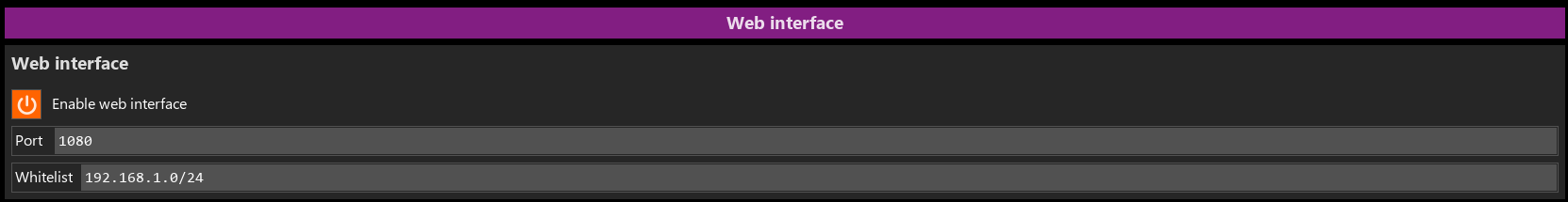

Hello playdublin,
Some routers/isp are using the port 8080,
so i would suggest to use a different port.
Also, could you please check the Whitelist Part
and modify according to your network, e.g. 192.168.1.x/24 ?
Furthermore, please make sure, that you will disable and re-enable
the web interface, after some change/modification.
Attached an example:
Thank you!

Hello.
I tried and it is working as expected on my mac,
via browser with IP Desktop, e.g. <192.168.1.something> : Port , e.g <1080>.
Please, make sure, that you have connected to same network,
for both devices.
Also, please check the Whitelist Part and modify according to your network,
e.g. 192.168.1.x/24
Thanks!
