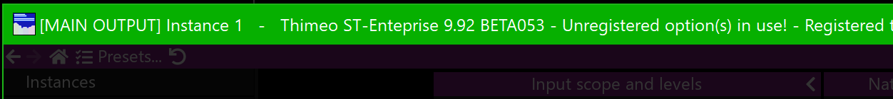

This is among the last things they change upon committing the code to the next version compiler. If you look in the app window's titlebar, it'll show the correct version.
Is that the app's title bar? No it's the properties box.

I just added it for you it shows 9.91 not 9.92 The property boxes are for all the dll showing 9.9.0 version
The installer is not the app...
