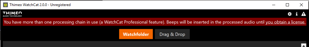

This should only happen if you're using scripting or if you have multiple processing chains. In both cases, there should also be a message on top in WatchCat (with a red background) that indicates what's wrong:
Can you confirm that you do not get this message? Because that would indicate a bug. Otherwise, the message should clarify what's wrong.
I do not get this message. I'd show a screenshot, but I cannot within this subforum. I even tried removing any existing presets for post scripting in case it's trying to do something there, and that didn't help. But now that I see there's supposed to be a message indicating something is in use without a license, I definitely feel like it's not behaving correctly.
