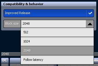

block size and behavior for the legacy agc is also another feature id like to see put into the current agc.
RMS in current agc seem to have little to no effect versus the legacy block size
