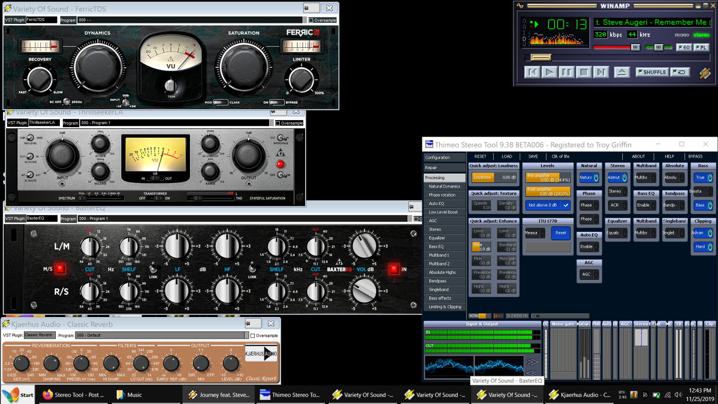

Note
I use winamp with a dsp stacker and multiple vst bridges into stereotool -> tape simulator -> tube amp simulator -> a Mid/Side mode Eq Just for reducing some stereo effect -> reverb effect "I use headphones" :D ;)

I have played around with that. I placement of the effects is important, to give clarity i see this as a real system. I don't need to have extra reverb or less stereo image in the tape and tube parts, but if you look at the reverb it's near off, Thing of it like the Stereo tool Declipper, Low level boost, azimuth, bass clipper, mono bass. Just for control, Now Tape and Tube for a more analogue sound. The Mid/side matrix and reverb are basically the room. I use headphone or i seat close to the speakers. I hope is helps you understand. :)
