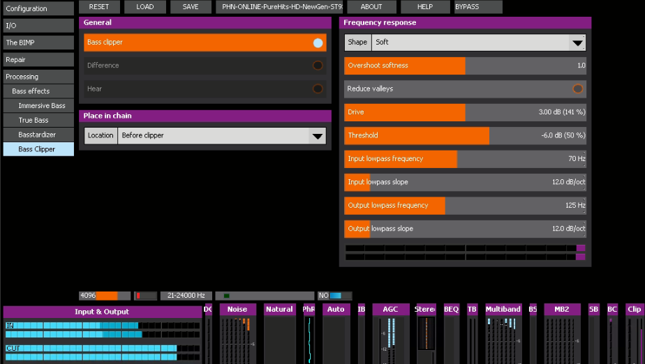

I am running Processing -> Bass Effects -> Bass Clipper with the following settings:
Shape: Soft
Overshoot: 1.0
Drive 3.00dB (I do this to add bass for older tracks lacking bass)
Threshold: -6dB
Input lowpass frequency: 100Hz
Input lowpass slope: 12.0dB/sec
Output lowpass frequency: 100Hz
Output lowpass slope: 12.0dB/sec
It's clipping, however even in Shape:Hard it's still letting through bass right up to 0dB.

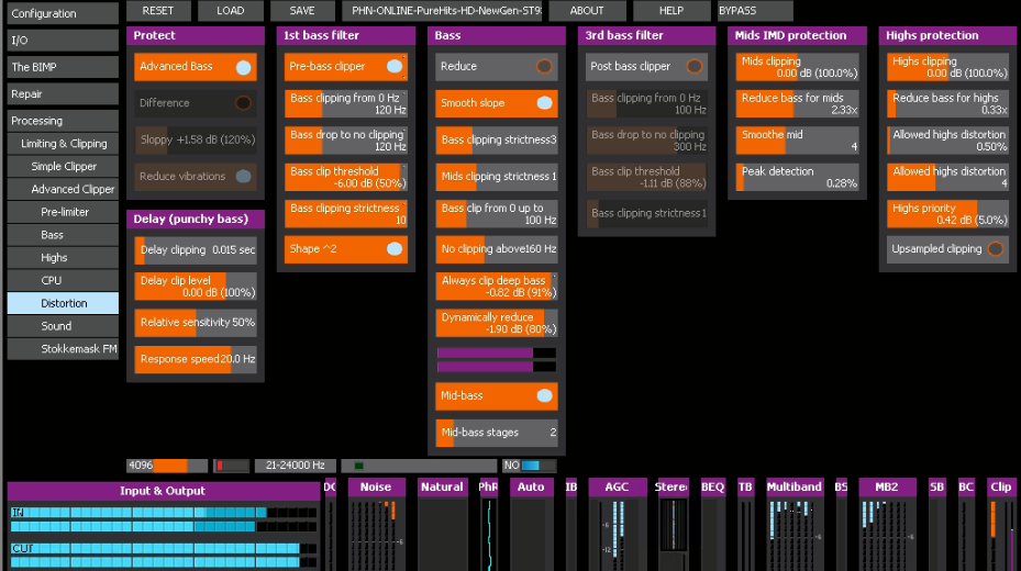

I've then attempted to hard clip using Advanced Clipper -> Distortion -> 1st Bass Filter -> Pre-Bass Clipper.
I set this hard to clip anything above -6dB with strictness set to maximum (10).

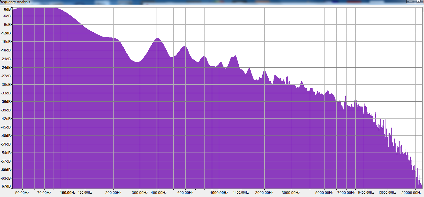

After playing some audio samples and running them through the spectrum analyzer bass is still peaking at 0dB.

File comment: Spectrum Sample
File comment: Advanced Bass Clipper settings
File comment: Bass Clipper settings

If you want stricter bass clipping then you should first of all disable Overshoot softness. That lets through overshoots on loud bass, which prevents adding too much harmonics. But it also results in more bass being let through.
PostPosted: Wed Nov 06, 2019 9:08 am
Joined: Thu Mar 19, 2015 12:24 am
Posts: 83
Hi Mathijsco,
Thanks for the reply.
Yes, I have tried that and many other combinations with the Bass Clipper, even turning it off and then forcing the Advanced Clipper to restrict bass, however that does not work.
