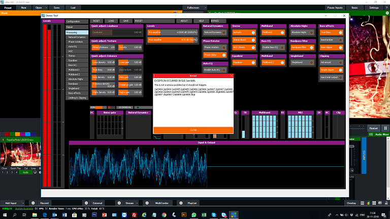

Hello Hans,
I think it is much better to post here rather than send you emails. I tried beta 11 in vMix and the same error appears. I attached the error message.
Kind regards,
Andre
PostPosted: Fri Nov 30, 2018 1:12 pm
Posts: 11464
Hi Andre,
On our end it *sometimes* works in vMix and it sometimes doesn't. David is looking into it, vMix refused to install on my pc (the installer crashed).
This is a different issue though. Could you send me your FULL settings? I'm assuming that something is going wrong in the processing somewhere. Alternatively, could you turn all the processing filters off one by one to find which one causes this? Start at the end... Just go to the main Processing screen and untick everything that's on, from the right bottom to the left top.

As you can see from the first screenshot, I downloaded a beta build of the VST3 plug-in for a previous version. Shows 9.02 in the About page.
