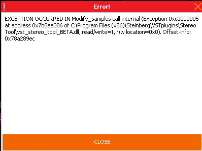

First crash I've been able to catch. It happened with the 32 bit vst2 in Reaper, causing its host to hang, requiring the DAW to be closed to close the frozen host. Before this, it was cashing and just breaking the plugin, so I don't know if this is the same error.
The previous instance of the plugin had crashed, muting the track audio. So I right clicked, Replaced FX, and the audio worked. But as soon I double clicked it to open the UI it hung. This happened while it was playing.
EDIT1: I'm attempting to register the 64 bit VST3, but the paste button is not working, and Reaper thinks there's nothing in my clipboard when I try to CTRL+V or CTRL+SHIFT+INS. Possibly Reaper's fault? I'll look up that method to create the file with the key in it and see if that works.

Hm, the crash is in a function called "__intel_memset". Which isn't very helpful (I can't see how it got there). What were you doing when it happened? Did the plugin run fine before and suddenly crash, was this during loading, ...? Does it reproduce?

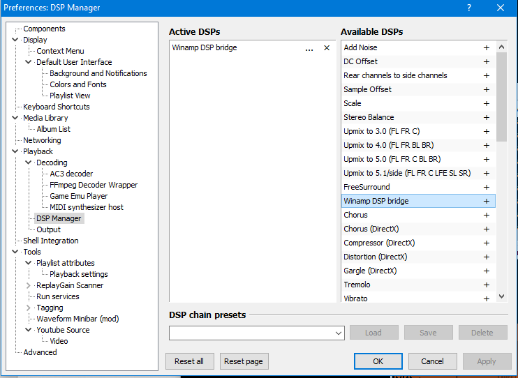

Loaded up the DSP in Foobar2000 using a dsp bridge (foo_dsp_winamp by CannibalZerg), and this error occurs the first time I try to play through it, every time. This same wrapper was fine in previous versions of ST.

And when I have the DSP deselected in the bridge plugin; if I begin to play music then choose it while playing, Foobar crashes entirely.

How do you select a plugin? I have installed foobar2000 and this bridge plugin, it shows up under Components, but there's only an about page - nothing else.
PostPosted: Wed Jul 29, 2020 10:01 pm
Posts: 1055
Preferences> Playback> DSP Manager> Winamp DSP bridge + > ... (settings)
