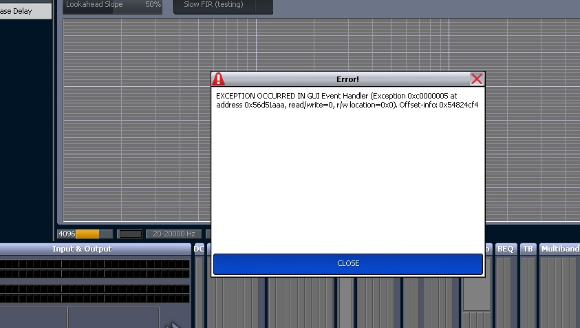

PostPosted: Fri Aug 24, 2018 6:14 pm
Joined: Tue Aug 13, 2013 2:25 pm
Posts: 198
PostPosted: Sat Aug 25, 2018 4:01 am
Posts: 4165
Loading FM presets makes errors/nan's
PostPosted: Sat Aug 25, 2018 1:44 pm
Posts: 198
Thanks, Bojcha.
