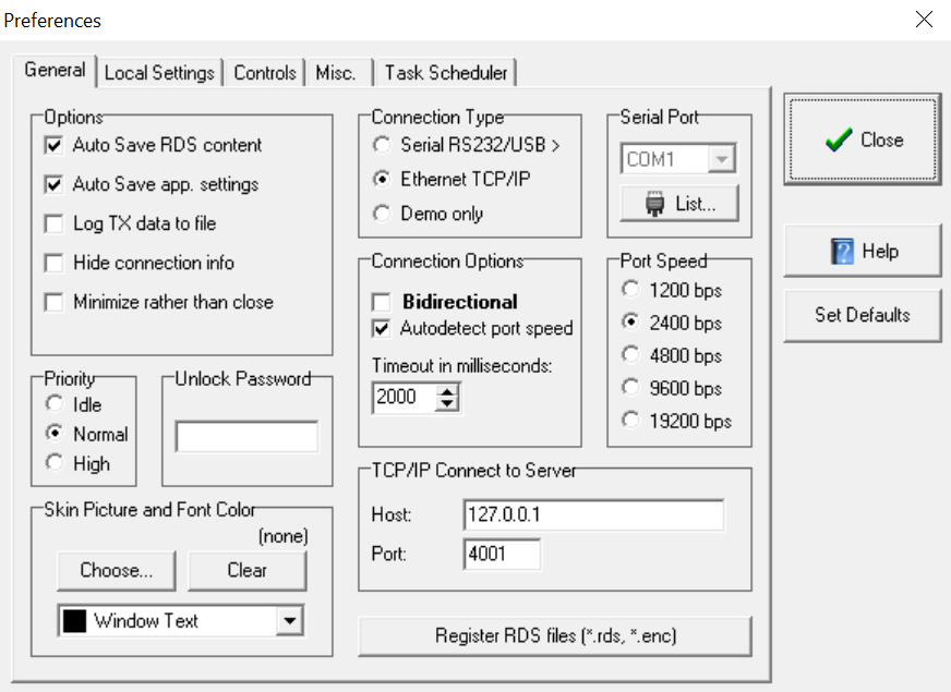

Old question.. but if anyone needs it, it works (at least partially, not all commands are supported, obviously MagicRDS was written to communicate with Pira's own RDS encoder and encoders differ in what features they support) in Stereo Tool 8.52 and newer. Here's how to setup MagicRDS:

Network : First we deal with commns
In Options/Preferences,
- set the bi-directional off
- set Connection type to Ethernet
- enter the Host and Port number for your Stereo Tool instance. EG, Host=127.0.0.1 Port=4001.
- Close out of the window
