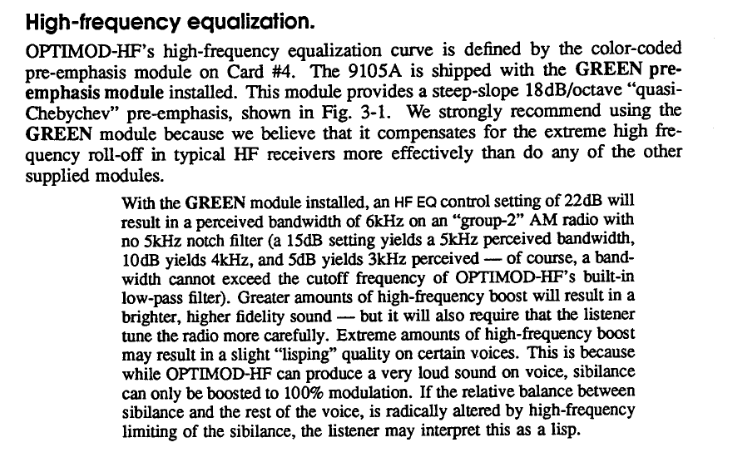

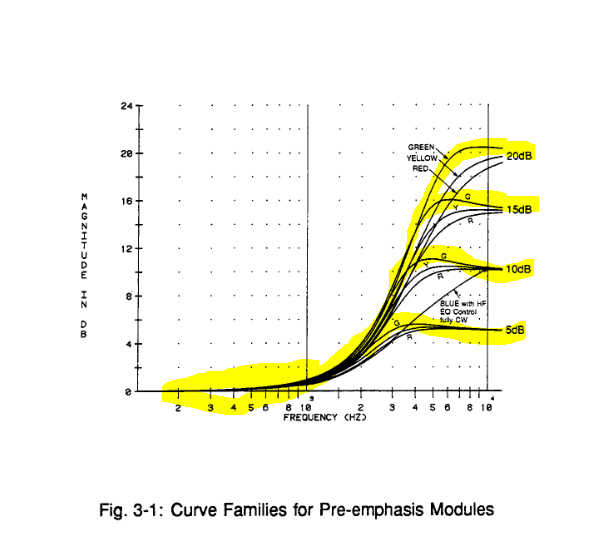

for AM transmissions, ST provides at the moment the 75µs NRSC preemphasis.
For shortwave this can be to week emphasis. The Optimod 9105 HF provides a very strong emphasis (up to 22dB at 5 kHz) according to the "Green" named line on the screenshot. Do you think it's possible to implement these configurable preemphasis also in Stereo Tool?

Unfortunately there is no standard. So it's always a trade-off by the broadcaster to find a setting that fit most radios.
