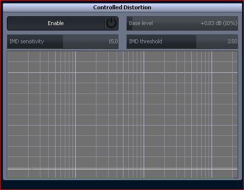

Can someone please explain to me what the Controlled Distortion control does? I've not been able to find any info on it in the help files. I'd also like to know what the settings do in Controlled Distortion.
