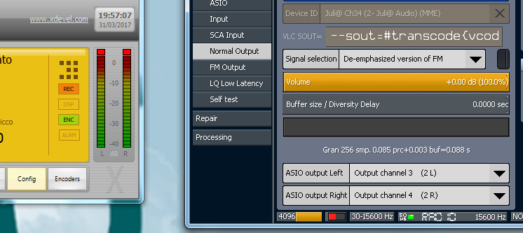

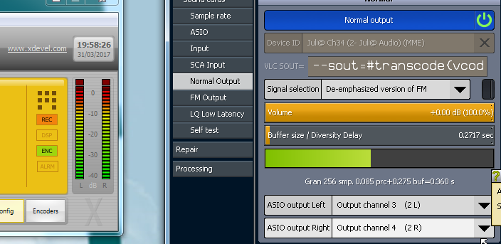

I use a soundcard ESI julia both transmitting FM (out1) and web streaming (out3 and 4).
Until version 8_00 I was forced to enter a buffer of at least 0.046sec to make sure that the FM audio does not jump, but from 8_12 can remove any buffer and the audio is ok.
If I do the same for the normal output it seems that does not work the clipper or limiter in which audio is slightly distorted.
Since I use the normal output for transmission on the web this is not a big deal but I feel obliged to report it.
File comment: Note left the sound level within limits.
2017-03-31 19_58_27-CasterX (Radio Evangelo Agrigento).png [ 49.54 KiB | Viewed 6327 times ]
File comment: Note left the level outside the limits (clipper or limiter not working?)
2017-03-31 19_57_08-CasterX (Radio Evangelo Agrigento).png [ 56.94 KiB | Viewed 6327 times ]
