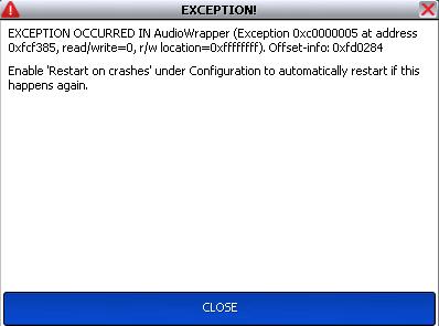

32 bit standalone crashes every 8 secs or so, even in bypass mode. Last beta worked great. Running Windows 10 home 64bit.
Emailing screen shot.

Bad news, Now I don't have sound from VLC or something else is wrong, I hear and see also somo tone and crash:

Ok, good news: It reproduces here too. Looks like a memory alignment issue (which would be odd). Will try to fix it asap.

beta26 on startup

Ok, good news: It reproduces here too. Looks like a memory alignment issue (which would be odd). Will try to fix it asap. Only release mode is affected (that's why I didn't notice it before).

Wow. This is the strangest compiler bug that I have ever seen.
So I use a string - "Stream (via VLC)" - at multiple places. (And I just added a new one to correctly sort the sound cards based on their names and still keep this one at the bottom).
So in one place I used:
strcpy(some_variable, "Stream (via VLC)");
In another I now added:
strstr(some_other_variable, "Stream (via VLC)");
For the strcpy, the compiler sees that it can perform the full strcpy with just 2 SSE instructions (it's a 16 character/byte string). So, it loads the string into an SSE2 register and then stores it. This however requires that the string is aligned on 16 bytes, and until now it always was.
But now I created that strstr line, which created another copy of this string which didn't have to be 16 byte aligned, and it wasn't.
So far so good. But in a final optimization step, the compiler checks if strings occur multiple times, and if so, it throws all of them away but one. And the one it kept wasn't 16-byte aligned. Which caused the code to crash. Ugh :(

- Fix for compiler bug (crash in 026)
