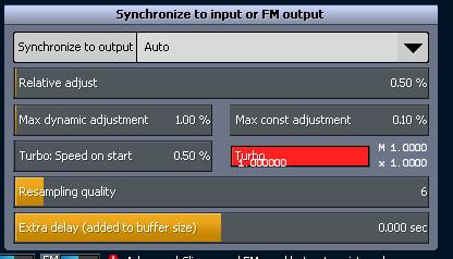

Just little cosmetic correction. The value is under the text "Turbo" and is not looking good - may be next to it with some space.
Edit: I hope now the GAPs when enabling disabling some output, will be gone ? I mean when FM is enabled, when i enable Normal out.. it make a GAP on both places . Is it possible now to make it not act like that ?
