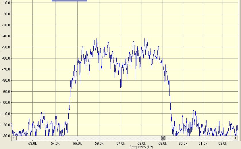

in older versions the bandpass filter was looking more STEEP..
But in latest versions it looks different ?!!? Any explanation about this one ?
i see that there is peaks to -80db ... where in old versions they was at max -90db down , and everything from the value of lowpass to pilot signal was more strong down. Now it seems to be softer .... Hans did you do something to the filter ?
I`m talking about these ones in the picture.... on older versions it was not like this.
Is this with the same preset????? This should only happen if you use a high value for the FM composite limiter.

I never use higher value to the composite limiter ..
Yeah i use equally presets , my own build.
But i`ve never see it like this ??

I don't see it here (tested several presets). Could you send me yours? Also, the display really still goes down to -90 dB......

I've done several tests and the output here is identical (in terms of LPF steepness) to the output of older versions - I even compared against 6.10 (with old MB enabled and AGC drive increased to get roughly the same output level). Shape looks nearly identical.

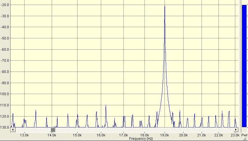

Something is really goin not so well....
Also i`ve never see this one . Old versions was flat at the bottom of the graph.
Latest beta is this spines. Only RDS and pilot enabled ! Also the same when only Pilot is presented.

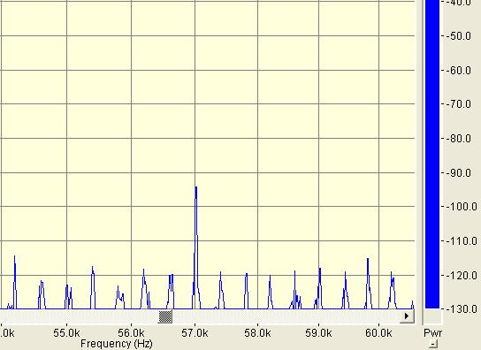

Picture of No RDS signal ... Still on 57Khz a signal !

Check your samplerate.
Edit: Ow now i see other picture. I wouldn't worry too much with -120dB signals.

Also RDS without pilot have some spurs around signal ...
