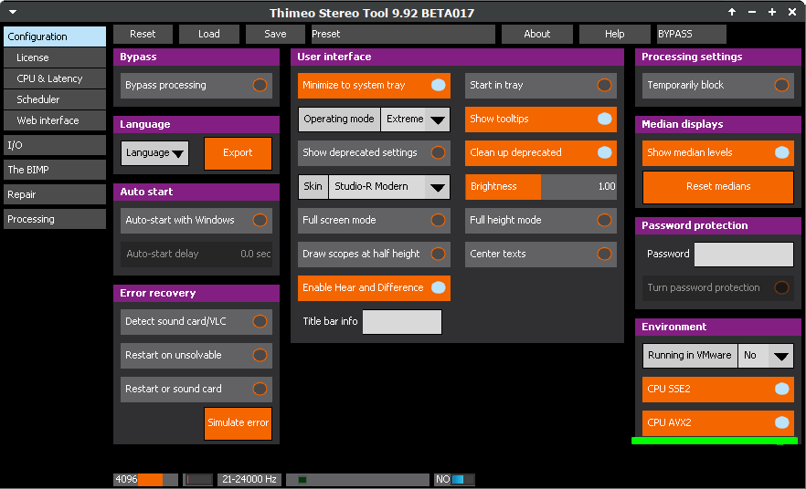

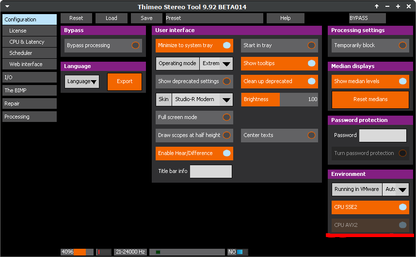

Even with older versions, I experienced the problem that AVX2 is not active on the Linux version. However, if I start the Windows version under Linux (with Wine), AVX2 is active there.
Tested with AMD Ryzen 5 5600X CPU on Debian 11 64bit.
