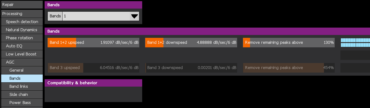

Oops, fixed. Also fixed the Latency AGC "Remove higher peaks" issue; the settings for band 1/2 and band 3 were swapped.
can you elaborate a bit more since i use the Legacy AGC exclusively ?
PostPosted: Mon Aug 09, 2021 3:08 pm
Posts: 11515
See this image. The "Remove remaining peaks above" settings for band 1/2 and band 3 were swapped, so if you load an existing preset in the last beta's, the values (130% and 454%) would be 454% and 130%.
