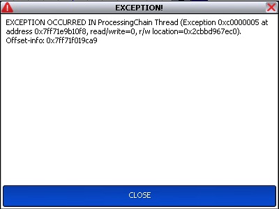

I find another error.
The error appeared after modifying the "Stereo Image" settings and returning to the Goniometer screen. I was able to close the error and the reproduction continued without crashing.
I can't attach the error image -> Sorry, the board attachment quota has been reached :cry:
Best regards.

Version: ST 8.54 BETA 009 - Standalone - 64bit
OS: Windows 10
Info: The error appeared after modifying the "Stereo Image" settings and returning to the Goniometer screen. I was able to close the error and the reproduction continued without crashing.
PostPosted: Wed Nov 15, 2017 2:07 pm
Ah! That's exactly the same error that you had before! (The address may have moved but that's only because of the rebuild). This is very interesting, because before I couldn't find anything that could have caused this... now that it happens again in a new build at exactly the same place, I *know* it has to be in this piece of code. (It still doesn't make sense to me, but I'll dive into it again).
Edit: Ah!!! I just tried what would happen if I send a NAN through the whole chain with Absolute Highs enabled (which I think is disabled in all of the built-in presets, but not in yours). I got a crash exactly at the spot of your error! So, I'm guessing now that editing the Stereo Image settings caused a NAN which in turn triggered this error (and, as you noticed, only once; it recovered immediately afterwards). So, I fixed the crash now (added protection against NAN's in Absolute Highs). The next thing to do now is to try to figure out where the NAN came from. Do you remember what you changed exactly?

Yes Hans.
I remember moving the "Image phase amplifier", "Image width amplifier" and "Center Bass" settings. Then I went back to the Goniometer screen and the error appeared.

- Octavafm's crash -> Happened once, didn't kill the audio (beside at the moment itself), recovered, message could be closed. Happened while changing parametric eq settings, but it crashed in Absolute Highs. Nothing suspicious according to Valgrind.... - Solved, was triggered by a NAN which caused a calculation to give an unexpected result, which caused a table lookup outside of allocated memory. Error has been there for almost 2 years, but would only occur if you have a NAN issue and Absolute Highs is enabled.

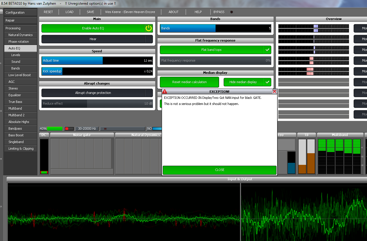

PostPosted: Thu Nov 16, 2017 1:15 am
Posts: 154
Location: Nederland
Veghel..we have a problem :D
Garbage in is Garbage out !
