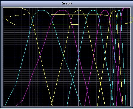

Ok.. understand you Hans .. but the question is .. is there any solution for this wobbling one .
And i have question : What is this line in yellow do ?
What does it means ? Whether i set the steepness or bands freqs .... bands are always crossing at this line ?!
Is this line we are able to move up or down in some way or parameter ?
Perhaps the crossing point of -6 dB (Linkwitz). http://en.wikipedia.org/wiki/File:Linkw ... rworth.svg
Where the sum of the bands gives a flat response.
by GAP
"Less is More" (Bob Katz)
PostPosted: Sun Mar 17, 2013 3:20 am
Yes it is, except that Hans's crossovers are not flat :)
And looking at that nice picture, corssover in ST is that pink line - more or less.
That line indicates -6 dB (each line is one, and the brighter ones are 6 dB apart each. Since the crossovers are at of very close to -6 dB, I made the -6 a bit brighter).
Why "approximately" -6? Because the total of all bands at each location must be '1' (0 dB). So if there are other bands that are much softer they will slightly lower the crossover point a bit further.
