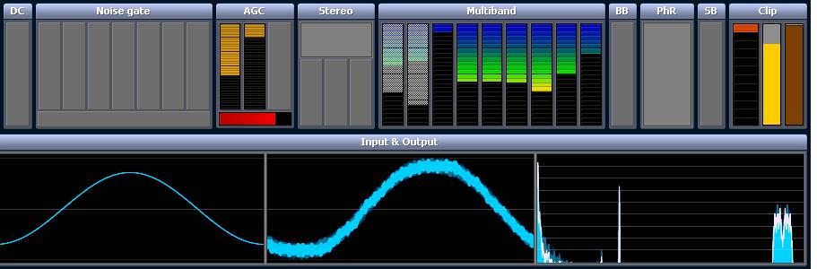

If i low the latency about 1024 and 512... the issue is even rising . Both bands are affected (first and second) clipper is goin crazy ? May be at 8192 samples this will gone :P
