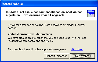

Bug found:
I loaded a preset with wrong asio settings for my ESI juli@ card and when i enabled asio and turned the channels off for fm transmitter, stereo tool exits with message.
To test this:
- Open stereo tool
- Press Reset
- Set only ASIO Channels 5 and 6 on for FM transmitter output and 1 and 2 for input, all others off.
- Disable normal output and enable FM transmitter output
- Set FM transmitter ON
- Set buffer size lower, let's say 40.0 ms.
- Enable Asio if it's not yet enabled, set sample rate at 192000, priority Real-time, use multiple CPU on.
- Now click off ASIO channel 5, then click off ASIO channel 6.
- If it doesn't crash for you click on and off channel 6 or channel 5. Maybe it will even crash for other channels.
