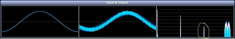

Hans , everything is fine with the CPU load (average 27-29 %) like is normal .. beta 53 and beta54 with equal tests and schematic of the test. I`m sure that in your system this is not appear, otherwise you will not post this version . But checked also the virtual cable state: No Uflows or Oflows... till signal is through the cable ( everything looks normal ) . i wondered of this effect because i felt it around the music and was shocked ?!? Other implementations are just in place but i don`t know why you don`t see this effect on your system . And may be others too.
Looks like no one is seeing this in beta54 .. Bojcha , Brian, ..others..
WOW... Also check this one : without the "synch to output" where this "buzz" appears - it looks like this: Some phase diff is appear. Phase in the input is 0 deg.Also if i disable the MB this in the yellow disappears.When put coupling to 100% this one in the yellow "circle" is rising up.
In beta 53 everything looks OK.

PostPosted: Fri Mar 15, 2013 1:09 pm
Posts: 11516
I'll compare the code against the previous version, and I'll build a version where I disabled one optimization that I'm not trusting 100% now (especially now that you see a phase difference).

I have built a debug version of the stand alone version and I'm getting several crashes. At very, very strange places. So something is definitely wrong, and this might explain multiple issues.
