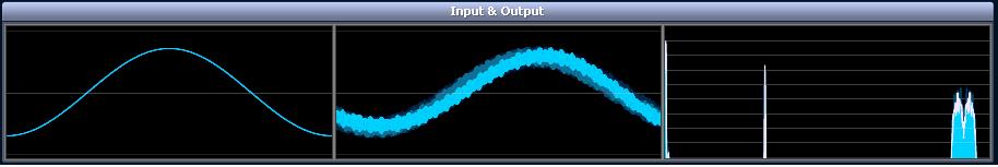

Thnk that there is some issue with the 54 beta !
Audio is some kind of high spikes loaded ? Look`s even at the input!
Signal is pure sine 40 Hz
Which version (stand alone, VST, DSP)?, and how did you test this? If this happened everywhere it would sound horrible...

Test like all versions. generator-> virtual cable-> ST
It`s the Stand Alone version... tested beta 53 and no any of this! but beta 54 is like the picture.
Yeah it`s horrible .
Here is the beta53 .. Clean !
P.S: Shadow in the output is from wave shaking :) from my video already show you.

Could this be somehow related to the sound card synchronization? I don't know... But almost nothing happens on the input so this is really strange.
Just checking: Input left/right is identical? I did optimize something a bit in this last version.

it`s from the optimization of synchronization.. If i disable it . it`s gone, but beta 53 is OK. So you may be optimize something more than needed :)
Just discovered that additional bass "shaking" also comes from EQ :|
