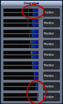

In beta 54, I found a small bug in the display of the median in the MB.
It happens in certain circumstances in any of the bands monitored within the MB, not in the overall monitor.
I happened to see it from beginning to use it sometimes, and it can be played down "Reset Median Calculation", especially when there is no gain reduction and comes a sudden reduction.
I upload a picture to view.
On the other hand, I think it would be good to put a check for "On / Off" displaying the median.
Edit:
- It is not easy to reproduce.
- It solved minimize and then maximize, it must be a problem with the refresh.

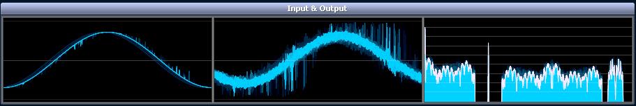

Thnk that there is some issue with the 54 beta !
Audio is some kind of high spikes loaded ? Look`s even at the input!
Signal is pure sine 40 Hz
