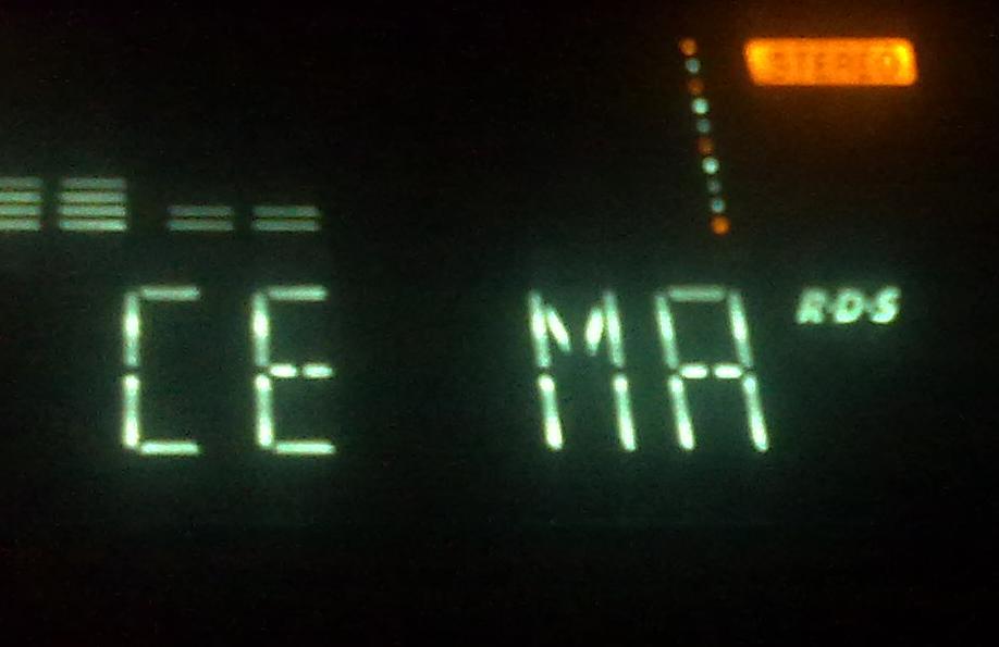

I tried
0000- cannot enter "0" as first symbol
all others that you gave are working as they are, and showed normally as they are typed in, nothing different.
Also everything exept "empty" is activating my RDS indicator.And i mean only the indicator .
Nevermind what i type or is empty , RDS is working good - PS, RT and other things.
So if it`s make sense to have anything different than "empty" , then leave it as it`s now.
It can be the chip that is used in my receiver !? i don`t know.
Do you have receiver with light for the RDS like this ? See the little RDS symbol next to the "MA" text.
When i clear the PI field, this light goes OFF !? But all other things continue to work as should be, PS is scrolling, RT is scrolling.. everything is OK

I've tried to Google a bit but I haven't been able to find a lot of information.
What I did find is: If you have only one frequency, you should set the 2nd digit to 0 (so FFFF would not match that, should be F0FF). Also, F is a valid country code, and 0 is not, so it would make sense to use 0 as the default for the first digit as well (00FF) - this could however be an invalid code since the 0 country code doesn't exist.
For the last 2 digits, the valid values are 01-FF, 00 means not assigned. Which sounds like what you want if you didn't fill it in.
So, I'm now wondering if I should replace the default FFFF code by 0. I'm just a bit worried though that some radio's or analysers might not like it and it might seem to people who start to use Stereo Tool that RDS isn't working properly.
OK, here is how i look at it.
In Holland the PI code is distributed by the Dutch FCC (AT)
So all licensed stations get their PI code from the authorities, and it's unique for every station. (also local community radio stations)
If you have a legal radio station (and thus a PI Code) and you run RDS carrier on that station, you are obligated to transmit PI code in the RDS signal.
So basically you always have to transmit PI, and that's probably why you don't find anything about non PI.
If you are an illegal radio station, i would suggest to fill in a fake PI (from an foreign country)
PostPosted: Sun Dec 27, 2015 12:39 pm
Don't set default to 0. I think it was like that long time ago and that one also didn't work on my tuner. FFFF is also the default in airomate.
PostPosted: Sun Dec 27, 2015 1:42 pm
I just test Airomate too.
When clear the PI field , RDS light goes OFF.
SO looks like there is no problem with this . Pi code must be presented.
So Hans, don`t make any changes about this .
