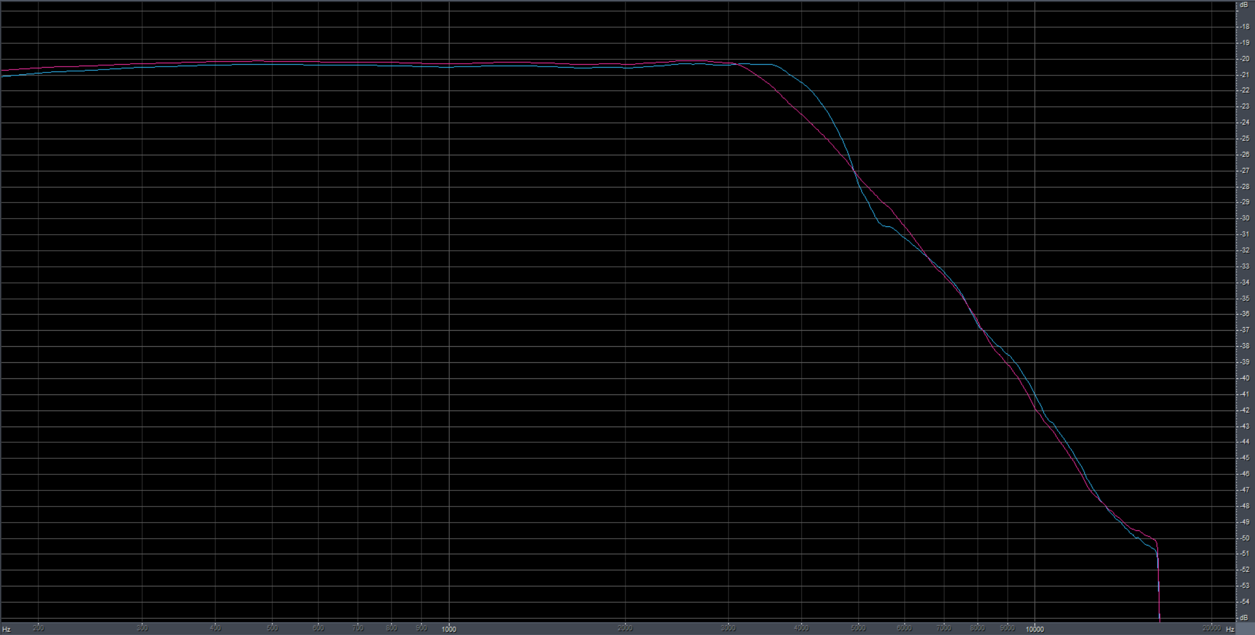

BETA026 is posted. The transition from mids to highs is a lot smoother. This image shows BETA025 (cyan) vs BETA026 (purple), with 75 us pre-emphasis and the highs clipper set to -6 dB to get extreme results.
Audio from 3000-4500 Hz is about 1 to 1.5 dB (in extreme cases) quieter than before. Everything else is very slightly louder; the total output seems to be the same in level.

BETA027 is posted.
The "Bass/Highs hole protection" -> "Protect against highs above slider" slider now controls the highs filter slope in ABDP, to attempt to always make a smooth curve like in the image I posted earlier. But now it works dynamically based on the setting of this parameter, which allows precise control over from which point highs will be reduced if pre-emphasis is used. This is now a very important slider which has a large impact on the audio. Default value is not changed.
Also, several GUI issues have been fixed.
