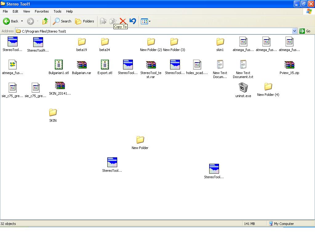

Here is screen for what i`m talking about
As for the "other skins affected" - yes . The only change i see is on the Green skin , because scopes are changing.
On other skins there is no change in colors ( for example "blue meter" skin)
Are you *really* 100% sure that you don't have a skin in that folder? Because what I'm seeing is that the things that still ARE responding to a skin selection - the on/off buttons on the main processing screen, and the scope - are exactly the things that didn't exist yet when the first skins (including Bojcha's) were posted. I can't think of any reason why exactly those would load and nothing else - in the code they aren't at the top or bottom of the list, so there's nothing that makes them different from the rest of the skin images.

Yes, i`m sure. Here is the folder content. No picture files.
Exe is started from this folder. Yes you see "skin" folders, but this is not the place where the exe is started.
So i think no skin dependend here.
Between, after restart - everything is OK again... If i make reset and load again - again problem.
The .sts file is in folder that contains "skin files". If this helps. But i think it must not affect things like that.
This means that sts files must always be in a "clean folder", right ?
I thought skin files are only read from exe, when started in the folder with the skin files.
But the case here is different - only the settings STS file is in a folder containing skin files. Exe is started from a folder that NOT contain skin files.
So i think you must check when settings are loading, if program searches for external skin files too - it must not.
