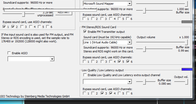

Hans attached is also the graphical bug like Russel mentions.
Running Win7 home premium on this laptop.
Screen resolution is 1680 x 1050.
Hi Luke,
1. Is that with the latest version (that is, AFTER I posted an update where I said that the issue was fixed, in the 5.00 BETA thread?)
2. The font looks completely normal (not 120 DPI but the usual 96), is that correct?
PostPosted: Fri Apr 09, 2010 10:29 pm
Posts: 184
Location: on the www
Hi Luke,
Hans, apologies, didn't go for the last beta it seems.
Seems fixed now.
Now go and grab that Heineken, I'll stick with a Duvel.
