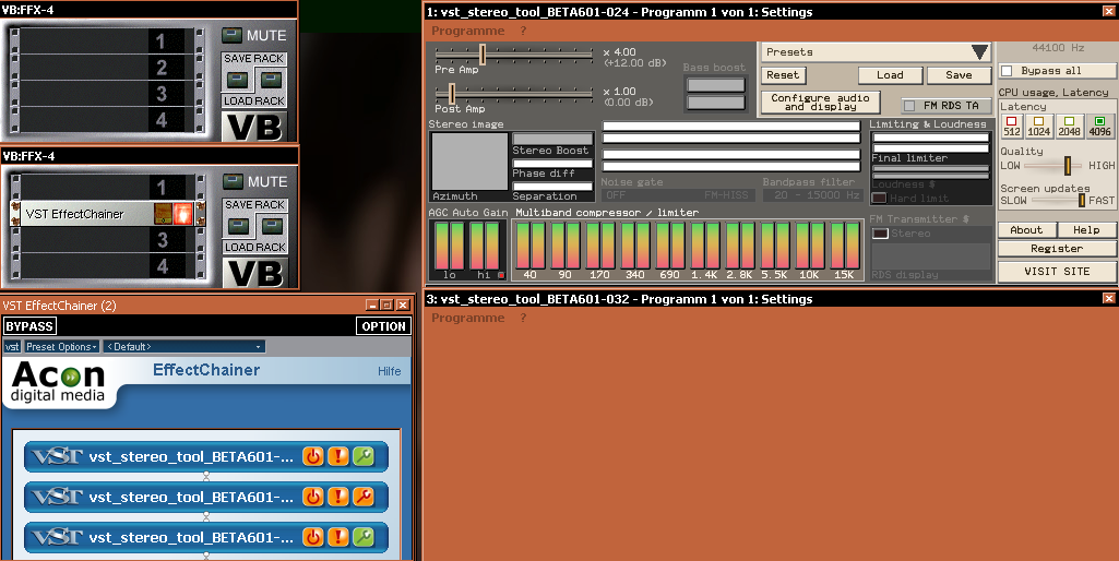

Posts: 475
What has changed for VST version with latest Beta builds ?
Last one I had tried was Beta 013.
Tonight I have tried latest Betas.
Betas 032 - 036 (and so I guess 037, etc.) have an empty window hosted with the Acon chainer (but not in Wavelab's internal FX rack !) .
I have not downloaded every Beta, so last Beta that works here (correct window in Acon chainer) is 024 !

 Post subject: Re: Stereo Tool 6.00
PostPosted: Wed Feb 09, 2011 9:40 am
Posts: 11481
BETA601-038:
- Updated Bojcha's Crucial preset.
Michi95: Might be the ASIO threading. Maybe that causes issues with the VST version. I'll turn it off for VST and see what happens.

@ Michi: Fortunately this time I could reproduce the issue (...). BETA28 is still OK, BETA29 GUI doesn't show up.
BETA601-029:
- GUI updates on IDLE priority thread
NO CHANGES TO ANYTHING ELSE!
That's what I expected to be the cause.
I think I should remove the separate GUI thread again - at the very least for the VST version. This thing does have some advantages though (less flashing) - I'll see if I can somehow keep those.
Edit: I cannot remove this thread for the stand alone version, because I need to be able to lower its priority. Will keep it only for the stand alone version, remove it for all others.
Edit #2: Seems to be fixed now. Testing some more, will start a build afterwards.
Edit #3: Yup, everything seems to be ok. Building BETA039 (hopefully FINALLY the last version for 6.10) now.

BETA601-039:
- Fixed VST issue in Acon Effect Chainer (and potentially in other programs as well): Removed the separate - and according to the Windows API, illegal - GUI thread in all versions EXCEPT the stand alone version (I need it there to make sure the GUI updates have a lower priority than processing).
