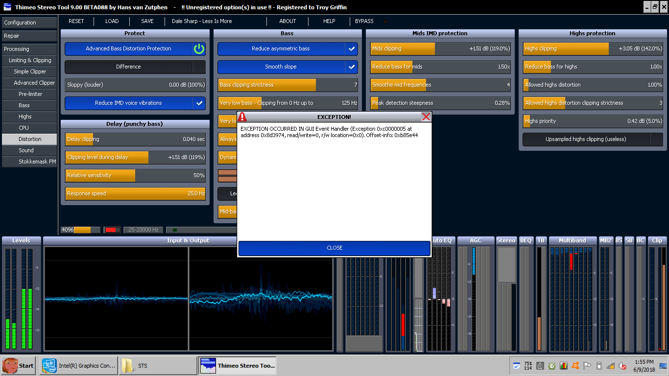

The audio is clipped when "Multipath Stereo Phase Difference Remover" is enabled
Wow - that looks really bad! Can you send me your full preset? I definitely have NOT seen anything like that here. (That multipath stereo phase difference remover is done at the beginning of the clipper, so it shouldn't have an effect like this at all on the end result).
Hi Hans. I've send the full preset by PM
Ah! Good! It reproduces here now. Not in all versions, but I found one which does it here. Looking into it now...

Posts: 217
Latest beta, Standalone, Win 7 32 bit.
Loading Dale Sharp - Less is More (Web/DAB/HD), I get:
Exception in: GUI Event Handler (Exception 0xc0000005 at address 0x1323974, read/write=0, r/w location=0x0). Offset-info: 0x15d5e44
Restarting: NO

Posts: 49
Problem when loading preset Dale Sharp - Less is More.

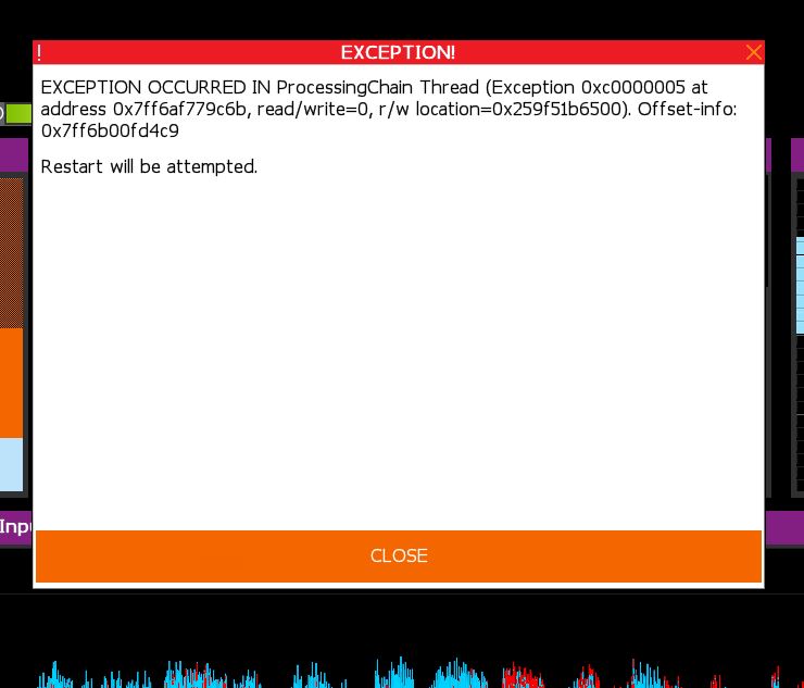

Posts: 118
Windows 10 - Stereotool Standalone 64 bit.
Issue: Sliding Quality (CPU load) in CPU & Latency from 100% to lowest figure (20%?) causes crash.
Stereotool recovers the first time however repeating it more than once, one gets what appears to be audio corruption (delayed, distorted audio).
