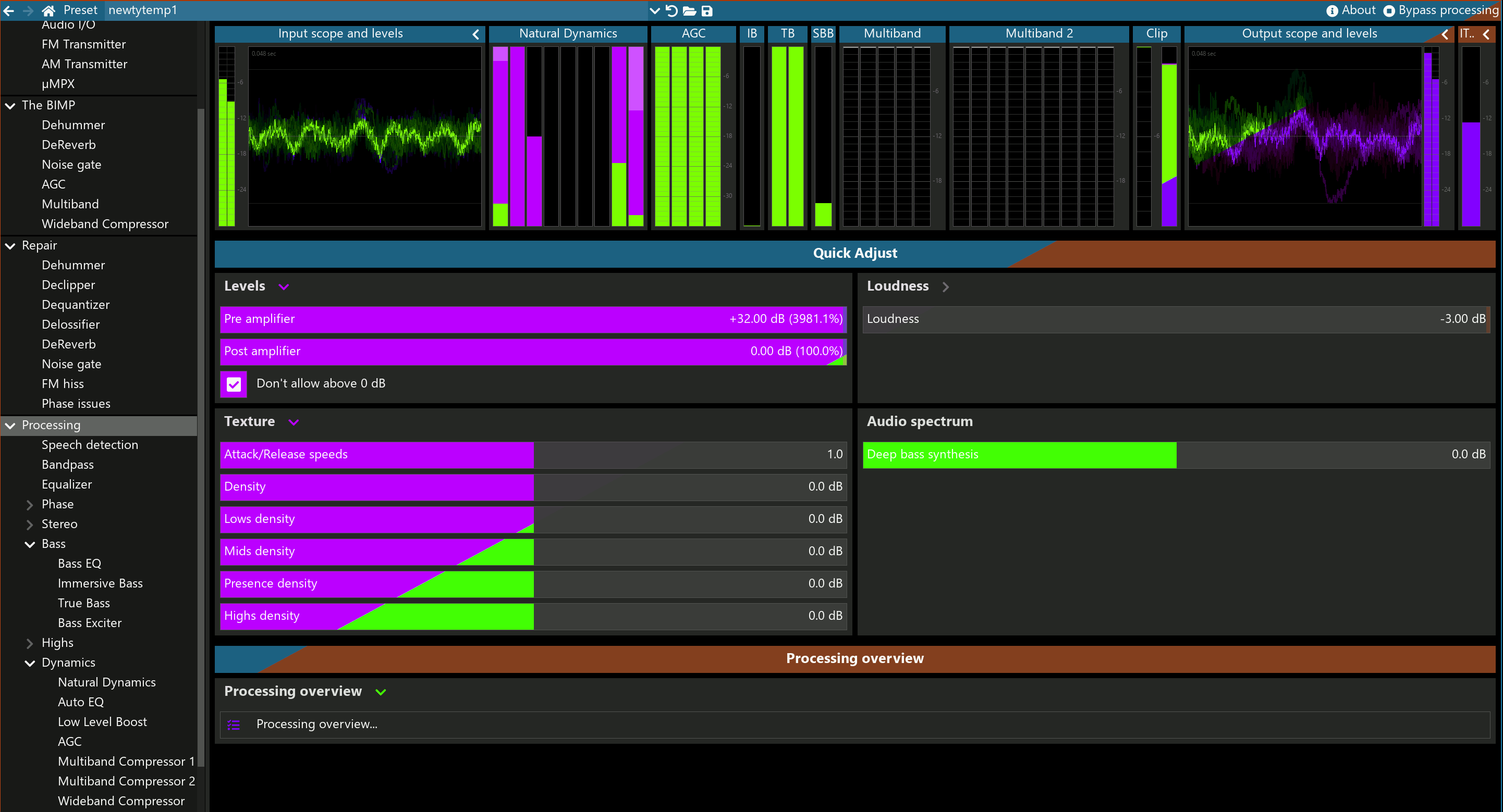

Regarding potential colorization:
I don't know what your plans are for implementing different color options or how easy this particular idea would be to implement, but a solution that doesn't involve individual color picking would be to 'rotate' the overall hue however many degrees in the render, if possible. For example in this attached screenshot, I've rotated the hue -100 and +100 degrees.
It's not always pretty, but it's effective for identifying a particular instance out of multiple ST Windows on sight. Yes, Enterprise is coming, but I actually want this for the plugin version, for working in a DAW.
File comment: example of hue rotation -100 and +100 degrees
