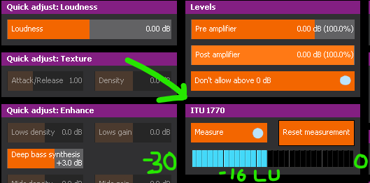

Since we now have the ability to affect the input level of the plugin and have it audible when bypassed, can we also get the ITU 1770 Loudness meter enabled during Bypass as well? I often find myself saving and resetting just to enable it to get a comparison reading.
Thanks!

we have ITU 1770 Loudness meter ?
Thanks!
Now you got me I'm second-guessing it... but yeah I was under the assumption that's what the thing is on the primary processing page under the Levels adjustment in the ITU 1770 measurement box. Advanced operating mode or higher.
