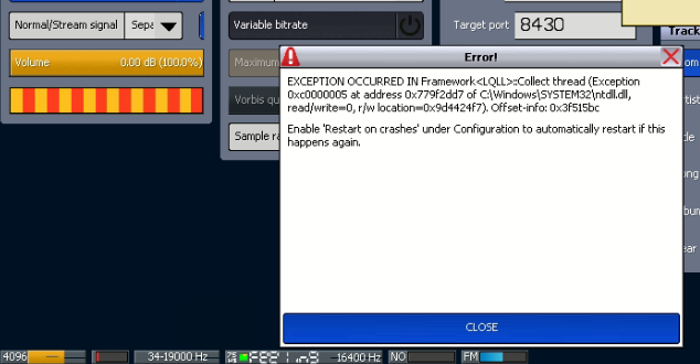

When I try to use for FM Stereo + Streaming at the same time crash...
That doesn't reproduce here, unfortunately. And the message shows that the crash happens in an external Windows DLL, so that doesn't tell me what's happening. Can you send me (in a PM) your *full* preset (SAVE -> EXPORT ALL)?
