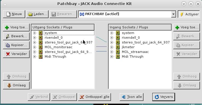

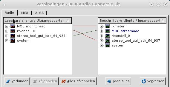

Bug report: ST 9.37 Linux, Debian, Jack had to put ACR Stereo off, channels were starting to echo, running out of each other, no other way to explain or understand it. Turning ACR stereo off solved the echo. Also attached a print from my earlier question, in "patchbay" ST has 2 instances in "connections" just 1. What is this extra instance, is this a bug?
