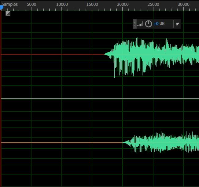

Unfortunately, the VST shift still exists in the current beta version. Left (top) is the signal from StereoTool and right (bottom) is the original signal. There is still a difference of more than 900 samples between the channels in this case.

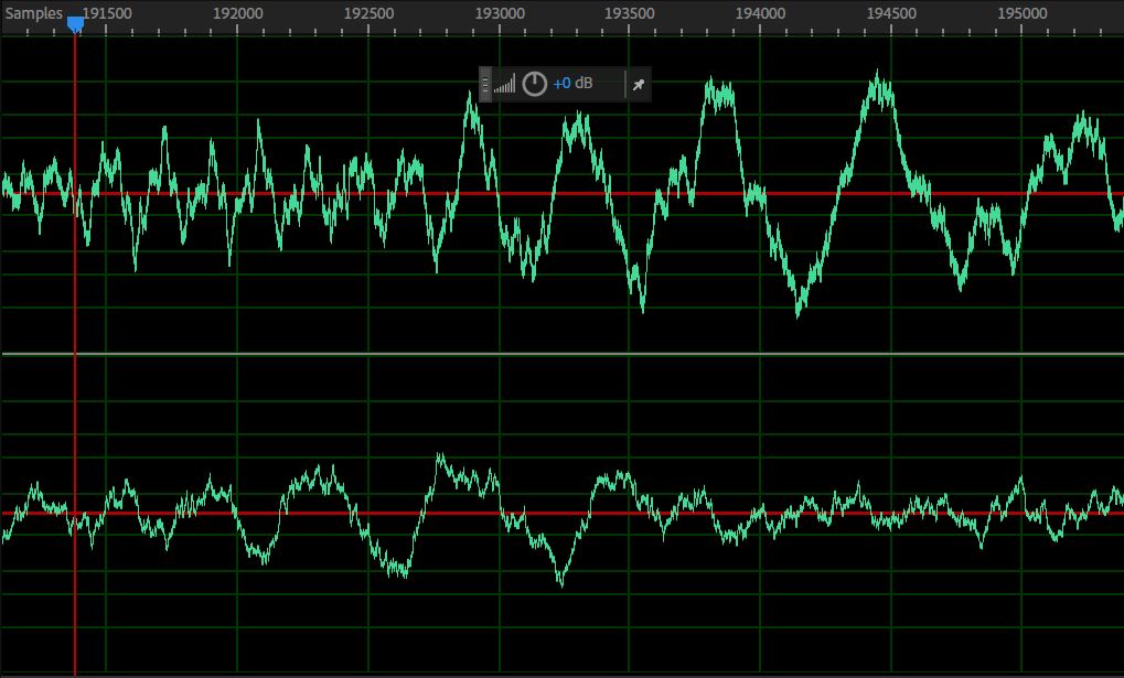

I discovered another strange phenomenon. If you now reset the StereoTool to the factory settings, i. e. if nothing is done at all, the signal output by StereoTool comes first and then the original signal. So the exact opposite from above.
Just to explain it in more detail. I don't see the problems with the conversion of music, this delay is insignificant. I'm much more interested in real-time applications such as OBS, which is used by many streamers, or video editing in programs such as Adobe Premiere. Here an added delay can be very unpleasant. As a result, watching a stream for the viewer can quickly become exhausting even if there is no lip sync.

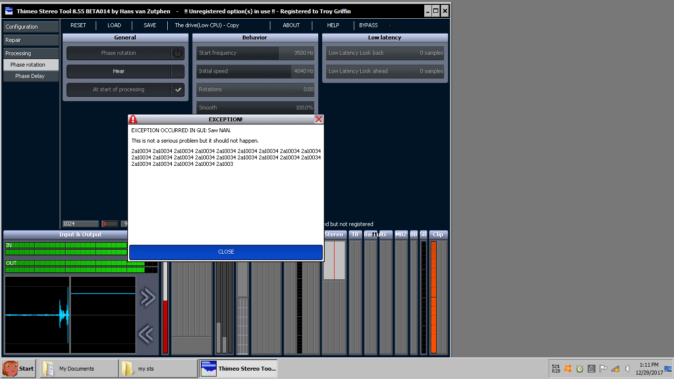

Hans we have a problem.

@the8trackkid: Did you do anything special before this happened?
Am I right that when you turn the clipper off, everything is ok again? If so (if it's still happening), can you turn things off to see where this is coming from? There should be recovery code everywhere where a NAN can cause issues, apparently there's a place where there isn't.
O, and what CPU do you have? And which Windows version? 32 or 64 bit Stereo Tool?
If it reproduces, can you send me your *full* settings (So the .ini file, in C:\Users\<username>)?
