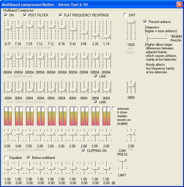

I notice strange behavior when closing and reopening stereo tool. The multiband behavior is very different.
When i reopen the same preset again it's very different. If i then close stereotool and reopen it again multiband is different.
This is with the pristine 6.1 preset with slight modifications.
EDIT: When checking it further it's because preset has strange steepness value.
 Post subject: Re: Stereo Tool 6.00
PostPosted: Tue Feb 08, 2011 9:36 pm
Posts: 11481
Is this the stand alone version? And what's a 'strange value'? So far I'm unable to reproduce this, and I don't see any clear errors in the code...
EDIT: Did you load the preset in Stereo Tool, or the preset file posted by Phoenix? That file does indeed contain a very weird steepness value (1e20 or something, a 1 with 20 0's...)
PostPosted: Tue Feb 08, 2011 9:39 pm
Standalone version, the problem is in the preset i think. When i open the preset i see the following.
PostPosted: Tue Feb 08, 2011 9:40 pm
Posts: 11481
@eldoradofm: I see you already answered, so I'll post my edit from above again:
PostPosted: Tue Feb 08, 2011 9:42 pm
Loaded the extern preset (file posted by phoenix) so that would have caused the problem.

- phoenix: "Change of Thread Priority: Now this really needs working. I'll try to make you understand the pattern that I'm observing. Normal and High donot work. Only REALTIME works depending upon whether ST is run using elevated privileges or not. So if I run ST as Admin, it changes to REALTIME in Win 7/Win Vista, else it sets it to HIGH. Now clicking on Normal or High puts it back to the priority at which ST was running just before setting it to REALTIME. So if it was set to Above Normal(using task manager), it reverts to that when clicked on Normal or High from ST Sound Confg Window." - BEHAVIOR UPDATED
- bojcha: When i change Soundcards samples it should ask me to restart program or somehow to deal with it. Currently it hangs. Moving buffer size or bypass ON/OFF, resolves it. - REPORTED TO BE OK NOW
- phoenix: ASIO sound disappears on enabling multicore. - SOLVED
- Allow setting Realtime priority on Vista (if possible, Admin rights?) - NOT POSSIBLE
- Change buffer size configuration to match whole ASIO grains (probably only displaying them) - DONE
- bojcha: I notice when Opening and starting program is a bit slower, minimizing to tray slower too. but it's ok. - Reported OK now.
- Hangups during closing of stand alone version. (hThread) Solved??? - NOT SEEN BY OTHERS
- Real-time priority +6/+5 possible instead of ABOVE_NORMAL and HIGH?
- Fix different priority settings - BUSY, waiting for feedback...
- Check/fix Bass Boost ringing reported by Bojcha for higher 'upto' frequencies. REDUCED it a bit, hope that suffices... Less steep filtering (ie. bigger difference between first 2 frequencies) helps. Another step is possible to reduce them further (probably 50% more) - DONE, FAR less artifacts now.
- Update Bojcha's Addiction preset
- Change version number --> 6.10 (there are also interface changes)
- Check forum for good new presets - DONE, some are good, but difference with existing presets is not big enough to add them.
- Add low latency generic preset based on Crucial
- Wait for Bojcha's final changes!
- Release
Questions:
* Multiband: Question: Is Steepness behavior ok? - AS GOOD AS POSSIBLE NOW, AND CAN BE TURNED OFF.
* Loudness: QUESTION: The changed Punch behavior, is that good or bad? Should I attempt to let Punch behave as it did in the past as much as possible, or not?
For 6.02:
- It's possible to send data to an audio buffer AFTER I've returned control to the driver if I call ASIOOutputReady() when I'm ready
- Add non-phase linear Multiband stage between AGC and incoming_copy_needed.
- Use double overlap (allow quality levels > 100%) to strongly reduce artifacts
- Introduce extra latency between 512 and 1024 by upsampling or downsampling
