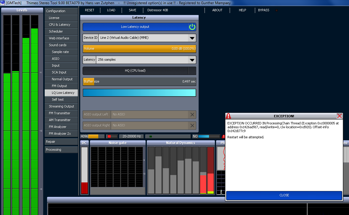

Meh! A freeze up when trying to use LowQ output for streaming
I fixed a crash like this a few days ago. Can you try 081? It doesn't happen here with the latest build.

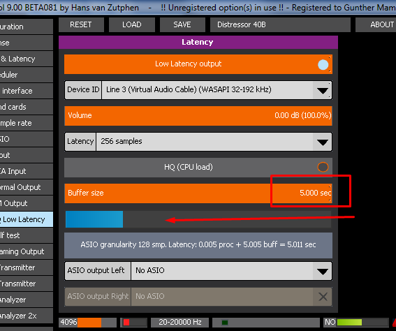

Ok, LowQ is working in v81, but now the buffer is running low, even with 5s latency.

PostPosted: Mon Jun 04, 2018 5:50 pm
Posts: 11460
That's probably the CPU load. Can you give it more threads? (under Configuration -> CPU & Latency, on the right).
Got 4 threads running now, same result, I'm gonna install 8.54 again, and see if the problem remains :)

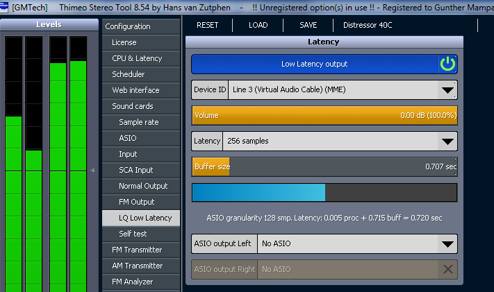

in 8.54 works great, strange things :(

PostPosted: Mon Jun 04, 2018 7:52 pm
Posts: 4240
In first case you use wasapi and in second MME. Also try to use KS.
in all 3 modes the buffer is running low, in v8.54 this isn't happening. Also with 4 parallel threads

Posts: 11460
There is a separate setting for the number of low latency processing threads in the right column of the CPU & Latency page.
Before you change anything there, could you check what the **low latency** CPU load in 8.54 is?
On my end with the first preset I tried I see a small difference (31% vs 33%), that could be enough though if you were close to the edge in 8.54 already.
OK, I missed the LQLL threads, it's working great now :) thanks guys!!!
