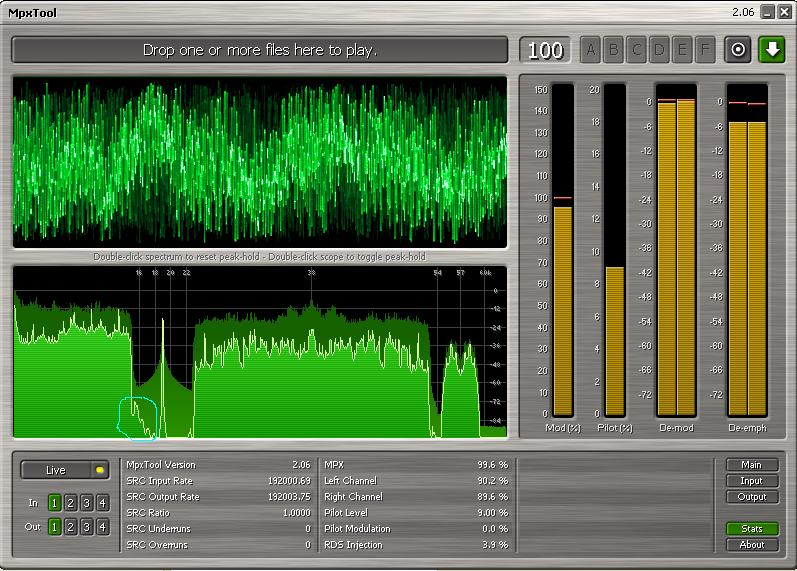

I think that 5.02 beta 25 is most common version exept that needs to correct two things . I test "Breakaway Broadcast Processor" everybody can download and test.
I Found :
1.correct the limit filter (i guess "hard limit") or look at the picture. I made a marker where is the problem. This ... might not be in the stereo signal. In the Breakaway broadcast processor this isn`t present.
2.when the HARD LIMIT is ON If there are highs present .. the bass gets low about 2-3 db which causes disbalance to the audio at this moment .Please correct this.
Remember that all corrections are only for BETA 25. If corrections are done
then this version is ready to next release. Thank You. I`m NOT kidding !!
It`s unnecessary to make other options to the sound , here in Bulgaria we call this options SHITnizers . So BETA25 has enough i repeat enough options . Don`t provide more.
File comment: Picture with the problem

@ Doggy...
That error in your mpx tool is not present here with latest beta. There is one beta where that occures (maybe you have exactly that beta) but that's solved in next build...
Highs lowers Bass in some moments: that's true, but not that much and that is not always because ST, sometimes it's because preset!
There is in latest beta protection for highs wich lowers bass, but again, not that much as you said.
