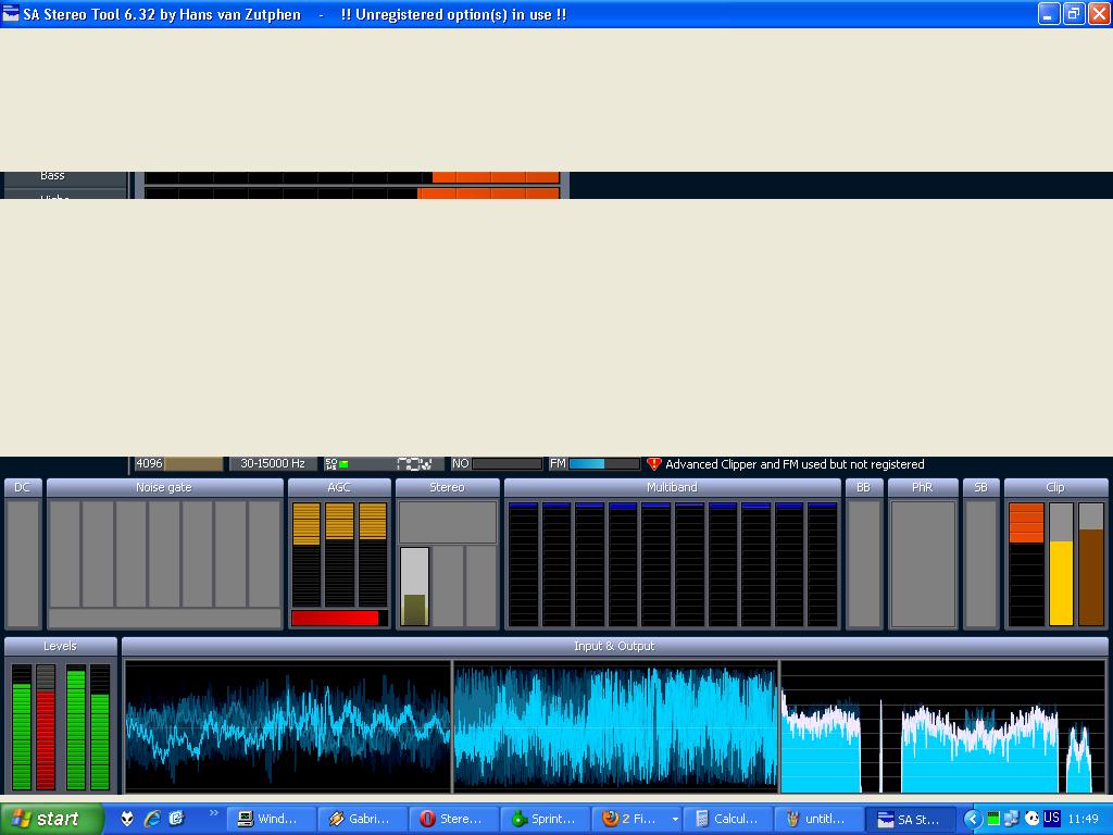

PostPosted: Wed Dec 05, 2012 10:51 am
I just notice a draw issue ...may be
Input indicator when goes to overshoot ( red ) in the background i see some other color ( not black ) to the moment when indicator goes green again .
And also when minimize ST to tray i have draw issues when restoring it from there.
Make a screenshot , and you will see the both problems. Input indicator ( right one ) and the screen
