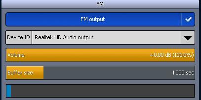

Are you people ( especially Hans ) have the problem after some time of playing buffer is showing low ...almost empty !! Say after playing 5-6 hours buffer goes bit by bit down to as little as a few pixels and stay there and play normal.
I must say that i have other programs like opera open . but i haven`t seen CPU 100% . I say that because i know that if CPU goes to 100% buffer will go empty ( may be ).

If buffer goes down by every minute.. there will be problems when it reach minimum, prolems like clicks (loosing buffer).
Reason for that can be anything.. starting from that soundcard is not exactly 192kHz. In your case it's bit more then 192kHz.
Belive or not, i notice that sample rate on some soundcards (mostly onboard) change sample rate a bit depending on motherboard temperature.
Anyway, asio + realtime priority should be used always when possible.
PostPosted: Tue Dec 04, 2012 8:59 pm
MPX tool shows my sample rate through Virtual cable : from 191994 to 192006... I think it`s quite good !!
Do you ?
Or tell me with what you measure it ?
Tell me what sound card ( not only ONBoard ) is having stable clock ?
Everyone is with Quartz crystal ( Not Temperature compensated Oscillator) right ?
So I must say that with old versions this is not appear !
I don`t know why you tell me for the sample rate but really i don`t see it with let`s say 6.21 or 6.20 ... i think even with 6.32
