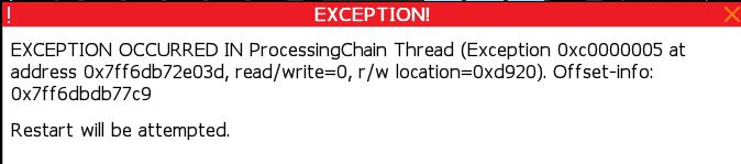

Stereo Tool 9.00 BETA079
Hi Hans
Continuous crashing/restarting until it finally restarted and froze...
Win10 64 Bit, ST9.00 BETA079 Standalone.
Previous beta was fine...
Rossco
PostPosted: Fri Jun 01, 2018 2:17 pm
Hi Hans
Rossco
Ah. Found it. Next beta should be fine again. Thanks for reporting it!
