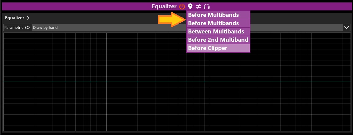

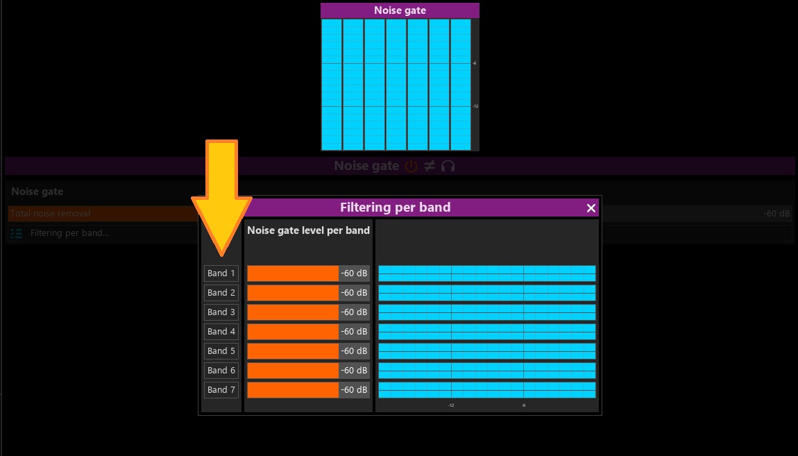

PostPosted: Mon Aug 28, 2023 12:25 am
Posts: 85
I have doubts, even one that I have consulted for a long time and I have not had an answer (Maybe it is a bug).
1. What is the difference between the first and second option of "Before Multibands" in the Equalizer section? (Bug?)
2. Why in the "Noise Gate" section is it not possible to adjust the bands or to know which bands the Gate control works?
Best regards.-
File comment: "Noise Gate" only show Band1, Band2 and so.
File comment: "Before Multibands" twice.
