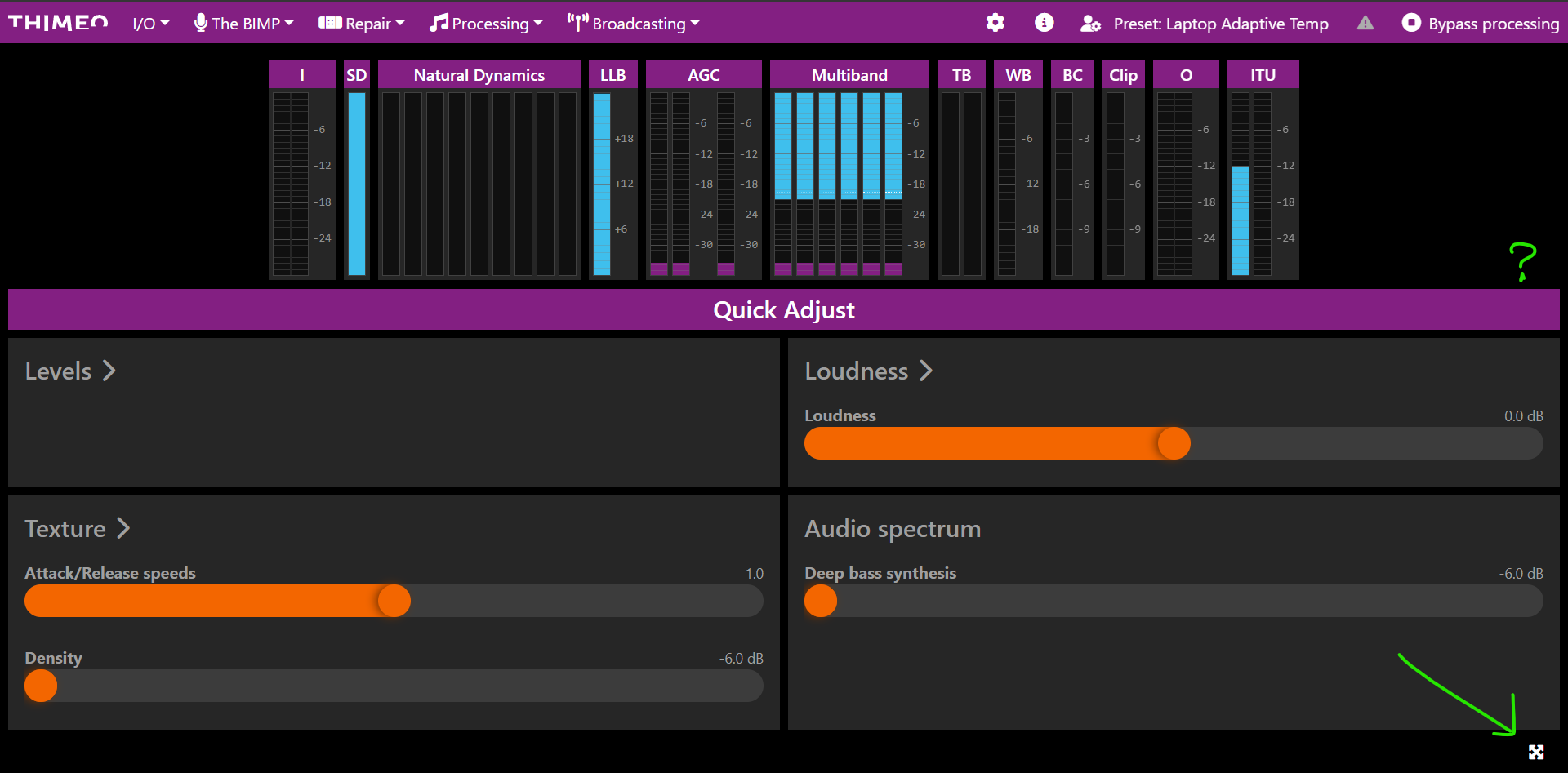

In the web interface, the expansion glyph for the oscilloscopes is in the bottom right of the screen instead of the cell.
