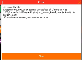

Ran into this error after doing a factory reset on the DSP version of 9.84 Beta 15. I loaded Bojcha's latest StudioHD preset and clicked the button in License to disable all unpaid add-ons. This is inside Station Playlist on Windows 10.

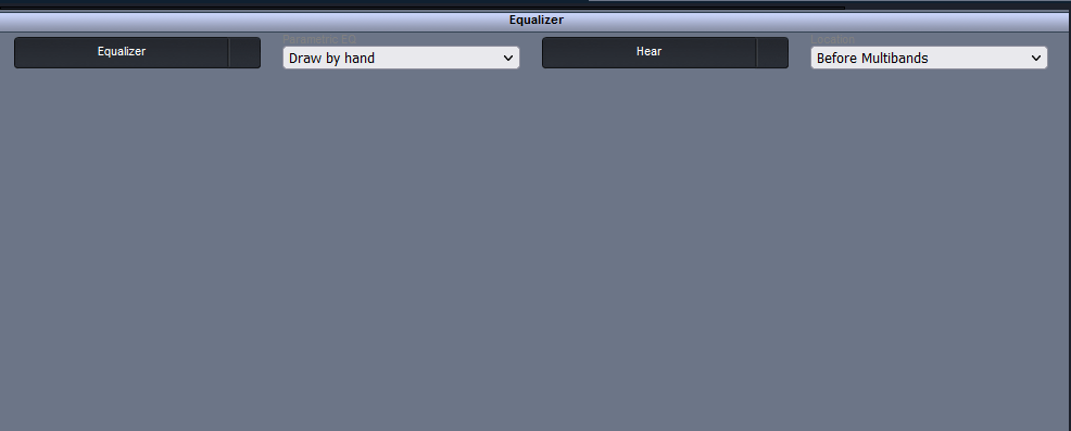

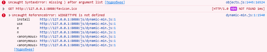

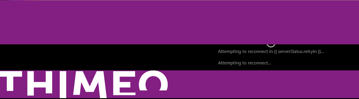

It does not affect the sound but i just leave it here.
Btw about sound: overall it seems sound more clear if compare with 9.83
Solved!
I think I have fixed this one too.
