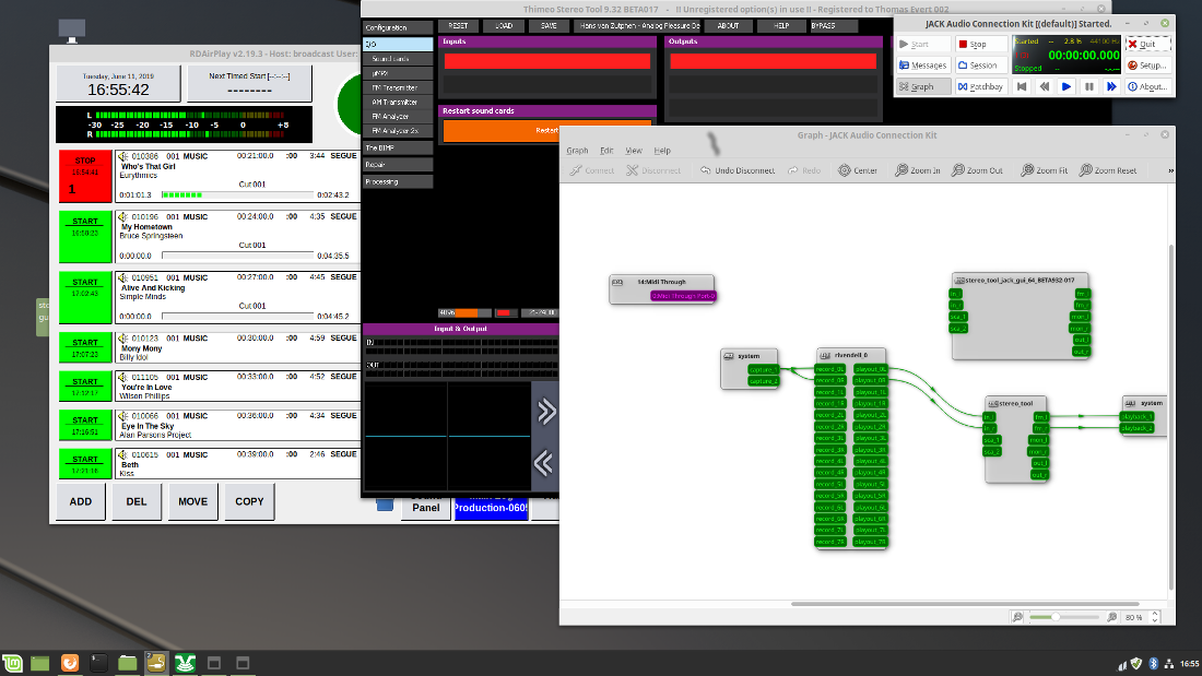

I have downloaded the /home/broadcast/Desktop/stereo_tool_jack_gui_64_BETA932-017 . I am having an issue with Stereotool not seeing jack at all. But only on the beta version. Jack is seeing the beta as is show up in Qjackctl. Stereotool ins't seeing jack :cry:
Kindest Regards,
Thomas E.
Burlington, Vermont
File comment: Beta

I think I found the cause. I tested that it worked, but I made some changes afterwards in the (Windows) code that seem to have affected the Linux Jack code as well. Testing now, if it works again I will run a new build.
Edit: Yes, fixed.
